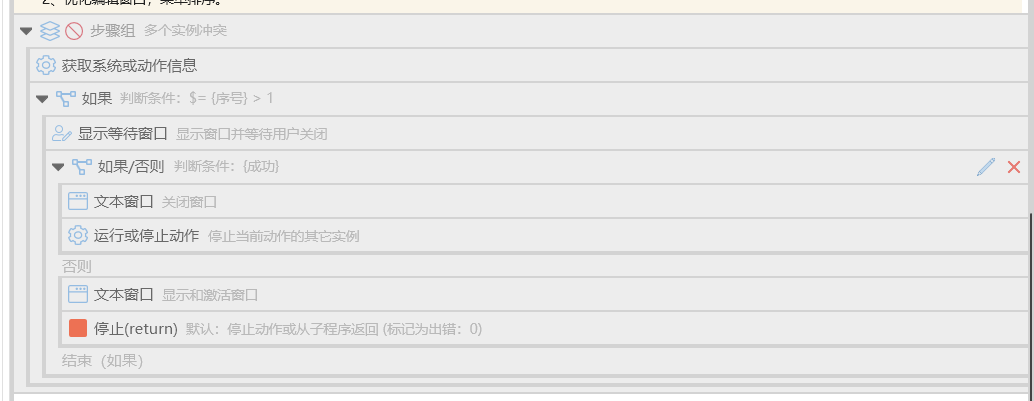

1、【待办事项】关闭了如图判断

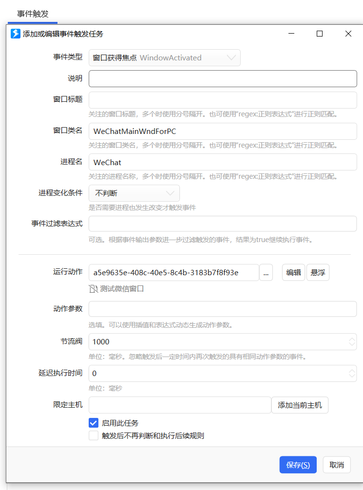

2、事件触发里是这样设置的
代码如下:
    "Id": "e453ef1d-dedf-4837-b8ee-931ea4205173",
    "Note": "",
    "IsEnabled": true,
    "EventType": "WindowActivated",
    "DebounceMs": 0,
    "ThrottleMs": 1000,
    "Params": {
      "WindowTitle": "",
      "WindowClass": "WeChatMainWndForPC",
      "ProcessName": "WeChat",
      "ProcChangeCondition": "NA"
    "LastEditTimeUtc": "2025-05-31T14:39:06.5494445Z",
    "ValidForMachines": "",
    "ActionIdOrName": "a5e9635e-408c-40e5-8c4b-3183b7f8f93e",
    "ActionParam": "",
    "SkipFurtherTasks": false,
    "DelayMs": 0,
    "EventFilterExpression": ""
